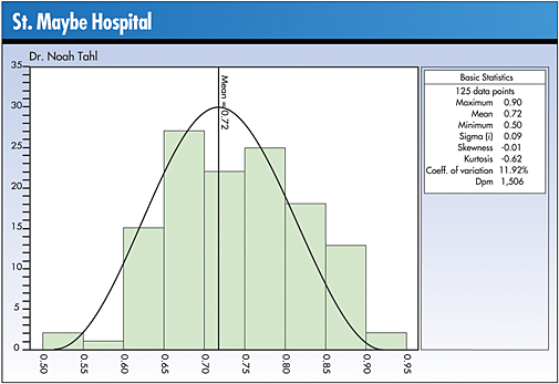

Alec Smart, one of his department managers, comes across the concept of the coefficient of variation as he explores the printout of his charted data. “What does it mean when the coefficient of variation is 11.92?” he asks.
Although the chapter on coefficient of variation isn’t one that Tahl has studied yet, he feels compelled to respond, especially because the entire class is looking expectantly at him. “That’s really the sum of the log of the standard deviation,” he mumbles. Although no one understands what he means, the trainees nod their heads and take notes.
Did Tahl provide the correct definition? And if so, is it important in health care? From the following, select the best description of the coefficient of variation:
A. The capability of a process
B. Whether a process is in or out of control
C. The peak level of a distribution
D. The ratio of the standard deviation to the mean
D is correct.
Coefficient of variation is a measure of how much variation exists in relation to the mean. Dr. Tahl’s guess was a meaningless collection of jargon. By obfuscating this simple technique, he was in fact robbing his trainees of the opportunity to gain another tool for data analysis.
Standard deviation alone isn’t particularly useful without a context. For example, knowing a standard deviation is 1.76 has no meaning, but understanding that a standard deviation of 2 had been anticipated provides a context that recognizes the variability is less than expected. Knowing the standard deviation has historically been 0.5 or less for a particular dimension, on the other hand, would suggest that 1.76 is considered high.
In examining the ratio of a standard deviation to a mean, the coefficient of variation provides a reference.
If the number is large, the data have much variability with respect to the mean.
A smaller number reflects a small amount of variation relative to the mean:
