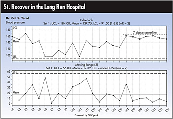

Which of the following is a correct statement about E2 and A2 with respect to creating an individual moving range chart?
a) A2 is always the correct factor to use because it comes alphabetically before E2, and one should use the first appropriate factor.
b) E2 is the correct factor because it estimates 3 sigma above and below the mean (X-bar).
c) For individual moving range charts, A2 and E2 will give the same answer.
Answer b is the correct response.

Applications of X-bar and R charts occur in health care, but individual moving range charts are far more common (sample size equals one).
One might track a patient’s blood pressure, or any other critical measure, on a daily basis. In charting this data, a different weighting factor E2 is used.
where:
UCLX = upper control limit for the individuals
LCLX = lower control limit for the individuals
k = number of samples
E2 equals the weighting factor used to estimate three standard deviations above and three below the process average.
