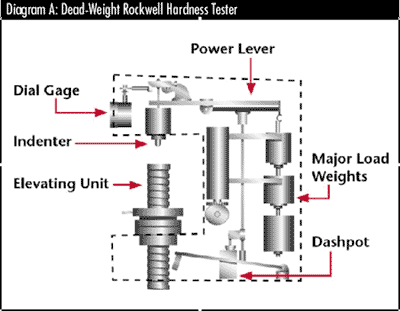

For more than 75 years, the most common hardness testing instruments have used dead weights to apply test forces. The reason for this is fairly simple: Dead weights are relatively inexpensive and easy to manufacture to the degree of accuracy required by commonly used test methods. The problem is that the force must be applied to the test piece through some type of small indenter. Transferring any dead-weight force to the tip of a small diamond or ball indenter—especially a force as great as the 150 kg used for a Rockwell HRC scale test, for example—is difficult to accomplish. The large size and mass of a 150 kg weight requires designers to use smaller weights with levers to intensify the force to the desired levels. Levers require pivots, guides and other friction-producing elements that can introduce errors. Although instrument manufacturers have done an excellent job trying to control these sources of error, any friction point in the system will have a negative effect that increases during use.
It’s also difficult to control the weight’s application in a dead-weight system. Because the dead weight must be moved to apply the test force, stopping it quickly without overload and oscillation is problematic. Many older testers use dashpots to control the application; however, these are prone to serious variations in test results because of seal wear and temperature changes. Many newer designs have replaced dashpots with motors. Although this eliminates some dashpot problems, the need to perform tests quickly makes motor speed critical, and as a result, force overshoot and oscillation are frequent problems.

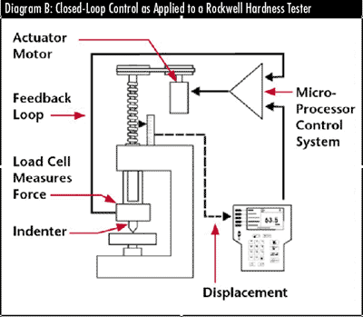

Not only is a closed-loop system able to constantly measure the test force being applied, but the components used in a closed-loop system inherently lend themselves to a much simpler design than those in a dead-weight system. As mentioned, dead-weight systems require levers, pivots and other friction-inducing components to function efficiently (see Diagram A). The indenter, the only part of the system in contact with the test sample, is detached from the weight, separated by the levers, pivots, etc.
In contrast, a closed-loop system’s main component is a strain-gage load cell. This compact, low-weight device provides an electronic output proportionate to the force applied to it. Load cells come in many different shapes; it’s therefore possible to design a hardness system with the indenter attached directly to the load cell (see Diagram B). With this design, sources of error between the indenter and the test force are eliminated.
These designs use actuators to apply the test forces, and although these actuators have bearings and sliding surfaces that may introduce friction, the design isolates these negative influences above the load cell so they don’t affect the critical test force. If, for example, friction in the actuator is so excessive that the desired force isn’t applied to the indenter, the load cell won’t indicate the correct force; therefore, the system will abort the test rather than give an incorrect result. In this way, the system constantly checks itself to make certain that only the correct test forces are applied to the indenter. The actuator’s mass can easily be controlled because of the feedback loop.
