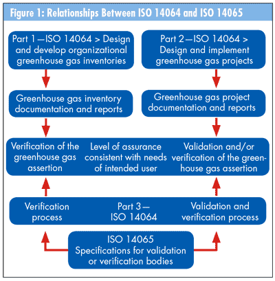

In March 2006 the International Organization for Standardization completed a multistakeholder process to develop a set of international standards for greenhouse gas accounting and verification, beginning with the release of ISO 14064:2006--"Greenhouse gases." ISO is also working on ISO 14065:2007--"Greenhouse gases: Requirements for greenhouse gas validation and verification bodies for use in accreditation or other forms of recognition," a complementary standard that allows for accrediting verification and validation bodies. That standard is currently in the final draft international standard (FDIS) stage and is expected to be published later this year.
ISO 14064 consists of three parts: Part 1 provides the basis for accounting undertaken at the organizational level, Part 2 provides the basis for accounting at the project level, and Part 3 provides the basis for validation and verification of both organizational and project quantifications.
The goal of both standards is to provide an international, policy-neutral set of tools to be adopted by greenhouse gas programs or used voluntarily to allow for consistency in undertaking and certifying greenhouse gas inventories and projects.

ISO 14064 Part 1 details principles and requirements for designing, developing, managing and reporting organization or company-level greenhouse gas inventories. It includes requirements for determining organizational boundaries, greenhouse gas emission boundaries, quantifying an organization's greenhouse gas emissions and removals, and identifying specific company actions or activities aimed at improving greenhouse gas management. It also includes requirements and guidance on inventory quality management, reporting and internal auditing.
Part 2 of the standard focuses on greenhouse gas projects or project-based activities specifically designed to reduce greenhouse gas emissions or increase greenhouse gas removals. It includes principles and requirements for determining project baseline scenarios, and for monitoring, quantifying and reporting project performance relative to the baseline scenario. It also provides the basis for validating and verifying greenhouse gas projects.
Part 3 details principles and requirements for verifying greenhouse gas inventories and validating or verifying greenhouse gas projects. It describes the process for greenhouse-gas-related validation or verification, and specifies components such as validation or verification planning, assessment procedures, and evaluating organizational or project greenhouse gas assertions.
ISO 14065 provides requirements for bodies that undertake greenhouse gas validation or verification using ISO 14064 or other relevant standards or specifications. It contains a number of principles that these bodies should be able to demonstrate and provides specific requirements that reflect these principles. General requirements relate to matters such as legal and contractual arrangements, responsibilities, impartiality, and managing liability and financing issues. Specific requirements include provisions related to structures, resource requirements and competencies, information and records management, validation and verification processes, appeals, complaints and management systems.
ISO 14065 can be used by greenhouse gas validation or verification bodies to self-declare their competency to carry out validation or verification activities, or may be used by greenhouse gas program administrators, regulators or accreditors to recognize the competency of such bodies. The standard can also be used as the basis of peer assessment among groups of validation or verification bodies.
