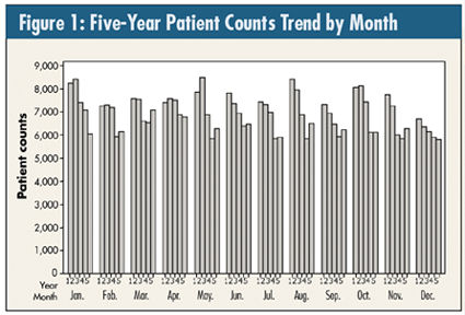

One day, I walked into a hospital administrator’s office and saw the chart in figure 1 on his desk. What is this obsession with bar graphs and presenting multiple-year data in this format? I can just hear some of you saying, "Well… er… uh… seasonality!"
In plotting these 60 observations in their time order, there are two distinct breaks: January of year three and four, due to new employee health insurance benefits kicking in. But regardless of the year and despite these January shifts, is there a consistent, predictable pattern of monthly patient behavior every year?

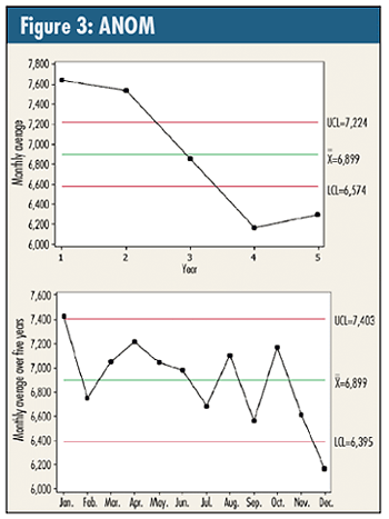

The analysis of means (ANOM) used to compare year-by-year and month-to-month "seasonality" are shown in figure 3. Three standard deviations are used for the limits. (See last month’s column on ANOM limits.)
The top graph confirms what the time plot showed: significant shifts in January of years three and four. If the "plot of the residuals in time order showing no pattern" diagnostic had failed, it would have invalidated the "significant process shift at January" model.
The bottom graph compares the monthly averages. The underlying structure of the standard deviation (i.e., the square root of the "error" term MS in the ANOVA) has inherently "adjusted" for these yearly process shifts so that they don’t interfere with this monthly comparison.
