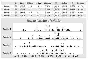

Here’s an example. Say you’re considering four vendors for a big contract. You’ve requested that each make a run of product that will supply you with 50 random samples for SPC calculations, as well as the lot’s production control chart and its Rbar/d2 estimate of standard deviation. Your specification range for this quality characteristic is 5,700 to 6,300. Regarding costs: vendor two < vendor one < vendor four < vendor three.
Your quality assurance lab comes up with a summary of the four lots based on the samples provided and produces the following comparative histogram:
From the Rbar/d2 calculation of the process standard deviation supplied by the vendors, you calculate their Cp and Cpk:
Your company’s statistical guru cautions that the data for vendors three and four aren’t normally distributed: “Vendors one and two both pass the normality test with p > 0.05,” he says, “although vendor four doesn’t quite fail the null hypothesis at the p < 0.01 level.”
His analysis of variance proves no statistical difference among the four vendors with a p-value of 0.307 and confirmed by the overlapping 95-percent confidence intervals:
