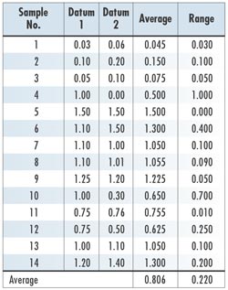

The data comprise 14 samples, with sample sizes of two:
His calculations look like this:
In this case:
To calculate the CpK, Simsack explains that one should divide the smaller Z value by three:
Simsack has no doubt impressed Abett, although the student’s eyes have glazed over slightly. “That’s all there is to it,” Simsack concludes.

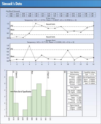

A week later, Abett brings Simsack a printout of the same data, with the X-bar and R charts as well as the histogram that he’s created from the data. Puzzled, he asks Simsack to explain the points that seem out of specification. Simsack dismisses the printout as a computer error because “Everyone knows that a CpK of 1 or more shows that you’re making virtually all good parts.”
Is Simsack correct in his observation?
Simsack is, of course, incorrect--again.
Arrogant enough to dismiss any obligation to check his conclusions, Simsack failed to check the two critical assumptions that are vital to capability studies:
The X-bar and R chart must indicate that the process is in control.
Data must conform to a normal distribution.
As the charts below indicate, Simsack’s data violate not one but both assumptions. Unfortunately, this means his conclusion--that a CpK of 1.17 represents a great accomplishment--is tragically flawed, especially when the printout shows 21.4 percent of the data are out of specifications.
