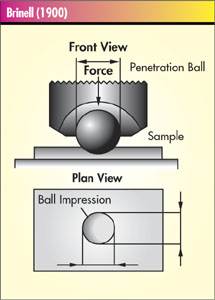

The Brinell method
According to Mark Antonik, hardness testing specialist at Sun-Tec Corp., the Brinell hardness tester first appeared on the market sometime near 1900.
Scott Robinson, a technician at The L.S. Starrett Co., elaborates. “Basically, a Brinell tester uses a round ball indenter to press into a piece of metal with a known force. That force will cause a dimple in the part. The harder the material, the smaller the dimple.” Once the dimple is established, it’s measured, and that measurement is assigned a certain value, as illustrated.
The problem with Brinell testers, however, is that the round ball indenter doesn’t necessarily make a clean, perfectly round indentation, making it difficult to measure exactly how hard the material really is.

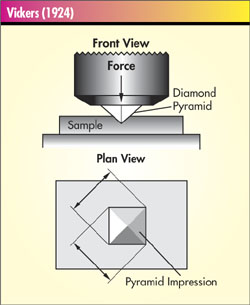

Along comes Vickers
Sometime around 1924, the Vickers hardness tester was developed.
The difference between a Brinell and a Vickers hardness tester is the type of indenter used. Where Brinell uses a round ball indenter to press materials, Vickers utilizes a square or diamond-shaped indenter. It’s the same basic principle as the Brinell, but the user has a device to measure more defined indentations rather than Brinell’s harder-to-determine round indentation. (See illustration.)

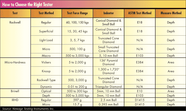

Choosing the right tester
According to Newage, there are several questions that need answering before choosing the right tester. These include:
Is there a hardness scale specified (Rockwell, Vickers, Brinell, etc.)?
What is the material being tested, and is it suitable for a particular test?
How large is the part?
What volume of testing has to be done?
How accurate do the results need to be?
What is your budget?
What problems have occurred in the past?
For a more in-depth look at how to choose the right tester for your application, see the chart below.
