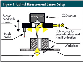

The diagram in figure 1 below illustrates the basics of optical measurement: lighting, optics, XY Stage, and a Z axis that handles the focus.
