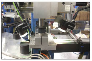

Two vision sensors are used at the station where caps are pressed onto the O-ring loaded on the assembly dial.

An automated oil-cap assembly system is a case in point. MPC engineer Brian Champion recently augmented traditional tooling and sensor technology with Checker vision sensors from Cognex Corp. of Natick, Massachusetts.
The MPC oil-cap assembly system installs O-rings into thermoplastic caps, and then prints on top of the caps. After an O-ring is loaded onto the dial fixture, it indexes to the second station. There, another in-line conveyor feeds blank caps to a second pick-and-place arm that presses the caps onto loaded seals.
