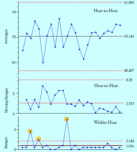

Three-way chart for steel tensile strengths

The average and range chart handles most situations where the data can be logically organized into homogeneous subgroups. However, this chart breaks down when faced with a hierarchical data structure containing two or more levels of routine variation. For these situations I developed the three-way chart in 1982.
