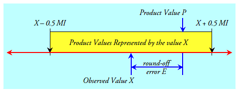

Round-off uncertainty

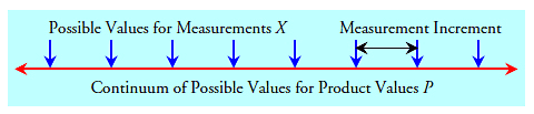

Assume that the only uncertainty in our measurements is the round-off. Since we only record observations to a finite number of decimal places, there will only be a finite number of possible values for our measurements. These possible values will always end up being some integer multiple of the measurement increment (MI). If we denote our observed value as X, then X will be some multiple of MI.
