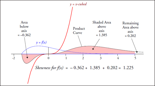

When a continuous probability model has an infinite tail or tails, that probability model can be divided into a visible portion and an invisible portion. To illustrate this I will use the probability density function for a standardized Burr distribution shown in figure 1.
Figure 1: A standardized burr distribution
