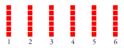

Consider a pair of dice used in games of chance. Each die has six faces with each face showing from one to six spots. If the die is a fair die, we expect each face will turn up approximately the same number of times in any series of repeated rolls. Here we say that each outcome between one and six is equally likely and expect any histogram to look something like figure 1.
Figure 1: Outcomes for the roll of one die
