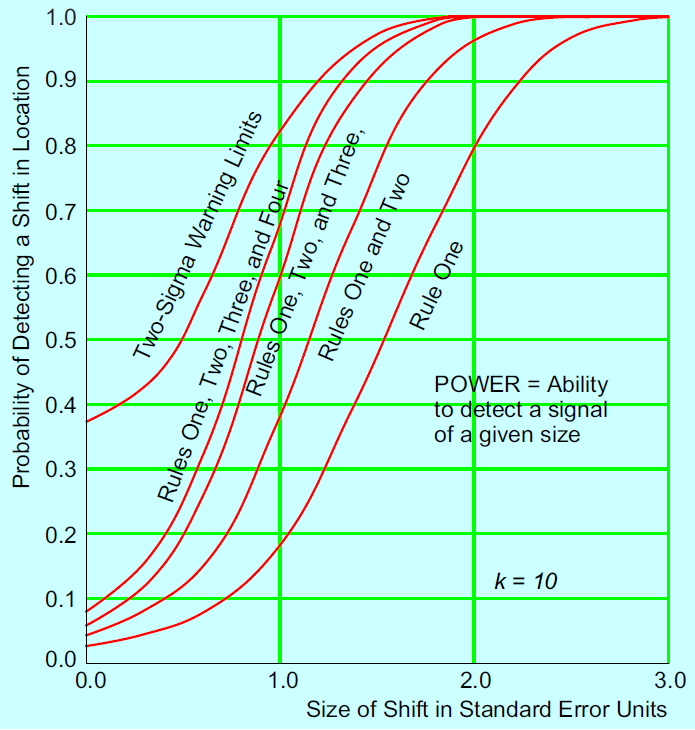

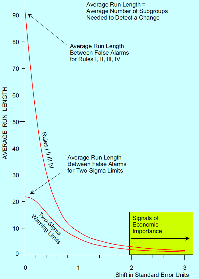

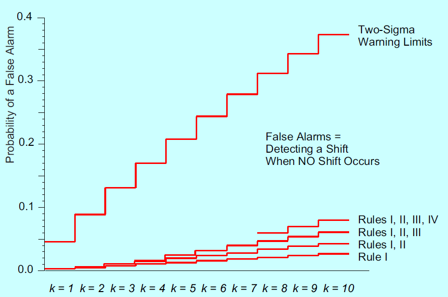

Ever since 1935 people have been trying to fine-tune Walter Shewhart’s simple but sophisticated process behavior chart. One of these embellishments is the use of two-sigma “warning” limits. This column will consider the theoretical and practical consequences of using two-sigma warning limits.
British statistician Egon Sharpe Pearson wanted to use warning limits set at plus or minus 1.96 sigma on either side of the central line. Others simply round the 1.96 off to 2.00. Either way, these warning limits are analogous to the 95-percent confidence intervals encountered in introductory courses in statistics. However, the use of such warning limits fails to consider the difference between the objective of a confidence interval and the purpose of using a process behavior chart.
