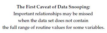

In “Data Snooping Part 1” (Quality Digest, Aug. 6, 2018) we discovered the basis for the first caveat of data snooping. Here we discover three additional caveats of data snooping.
Last month we discovered:
