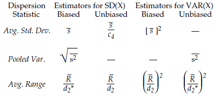

Recently I have had several questions about which bias correction factors to use when working with industrial data. Some books use one formula, other books use another, and the software may use a third formula. Which one is right? This article will help you find an answer.

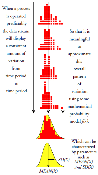

Before we can meaningfully discuss different bias correction factors we need to understand what they do. To this end we must make a distinction between parameters for a probability model and statistics computed from the data. So we shall go back to the origin of our data and move forward.
A statistic is simply a function of the data. Data plus arithmetic equals a statistic. Since arithmetic cannot create meaning, it is the context for the data that gives specific meaning to any statistic. Thus, we will have to begin with the progression from a physical process to a probability model, and then we can look at how the notion of a probability model frames the way we use our statistics.
Assume that we have a process that is producing some product, and assume that periodic checks are made upon some product characteristic. These checks will result in a sequence of values that could be written as:

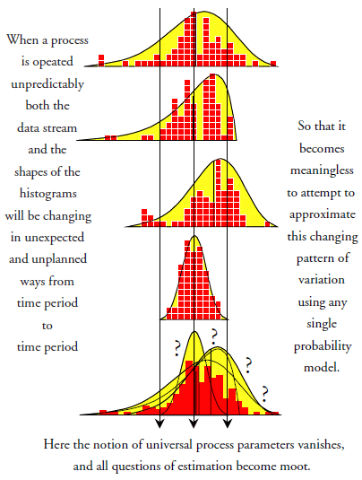

Shewhart had another problem - the one most of us have in this game - the problem of process data, where time is an important context. Although Deming named it, Shewhart developed the idea of the analytic study, which was necessary because he was (as Don describes so well above) taking data from a dynamic stream, not a static population. In analytic studies we don't worry about populations, because they don't exist as a practical matter - you could argue that if a process is stable then there is a population of data that is developed while the process remains stable, but who cares? That would be semantic angels on the head of a pin (in my humble opinion). We are not trying to use a sample to represent and extrapolate from that sample to a population. We are trying to use subgroups to represent the past and present and extrapolate to the future.
