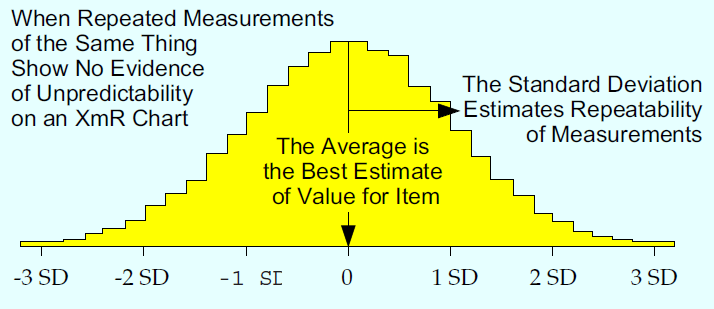

A Type 1 repeatability study starts with a “standard” item. This standard may be a known standard with an accepted value determined by some master measurement method, or it may be an item designated for use with the study (an “unknown standard”). The standard is measured repeatedly, within a short period of time, by a single operator using a single instrument. Finally, these repeated measurements are used to compute the average and standard deviation statistics, and these are used to characterize the measurement process. This technique can be traced as far back as Friederich Wilhelm Bessel and his Fundamenta Astronomiae, published in 1818.

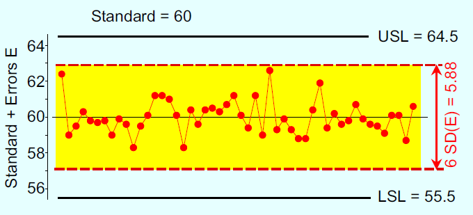

Submitted by andrewtorchia on Tue, 10/08/2024 - 08:07
Typo in Figure 5
There is a typo in Figure 5. You misspelled "Precision".
Submitted by Quality Digest on Tue, 10/08/2024 - 09:38
In reply to Typo in Figure 5 by andrewtorchia
Error fixed
Thanks for spotting that Andrew. Fixed!
