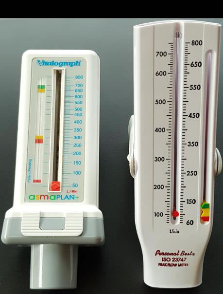

The aforementioned doubt also extends to healthcare, where measurement data abound. As part of the management of asthma, I measure my peak expiratory flow rate (discussed below), and I now have two handheld peak flow meter devices. Are the two devices similar or dissimilar? How would I know? To see how I investigated this, and to see the outcome, read on. A postscript is included for those wanting to dig a bit deeper.
