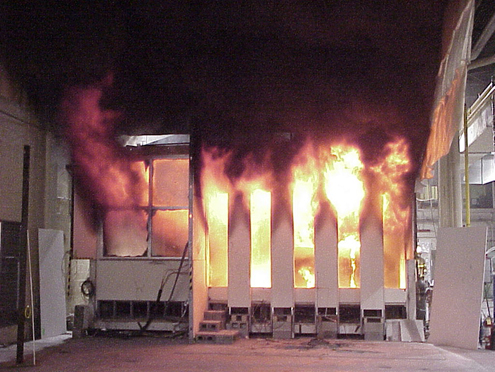

NIST experiment to replicate an office fire in the World Trade Center. Tests such as this helped validate computer models of the spread rate and intensity of the fires initiated by jet fuel and fed by the office furnishings and other combustibles.
