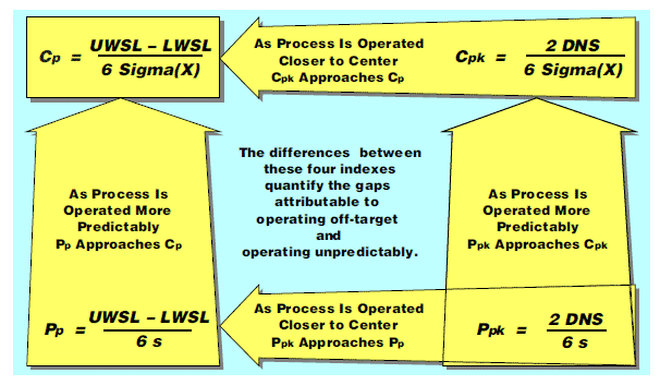

There are four capability and performance indexes that are in common use today. While many other ratios have been proposed, these four indexes effectively summarize the relationship between a process and the product specifications.
The capability ratio uses the difference between the watershed specifications to define the space available and compares this with the generic space required by any process that is operated with minimum variance. This generic space required is computed as six times an appropriate within-subgroup measure of dispersion, Sigma(X).
