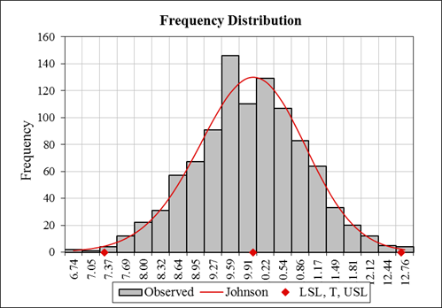

Consider the following capability assessment problem. The process is stable based on the control chart, the observations are approximately normally distributed, and the mean is roughly in the middle of the tolerance. Everything conforms to the assumptions required for validating the use of the traditional process capability formula for the indices Cp and Cpk. Hence the practitioner should feel pretty good about the validity of their process capability estimates (see figure 1).
Figure 1: An approximately normal distribution
