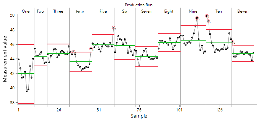

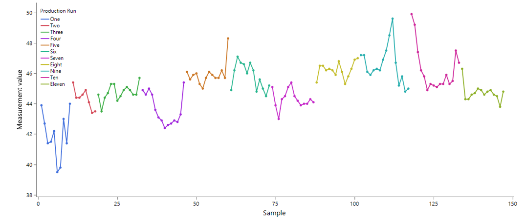

Time order of production
All, or practically all, manufacturing data have an essential piece of context, which is a time stamp. It’s the time stamp that allows you to put your data in a logical sequence—the time order of production—when you start the analysis.

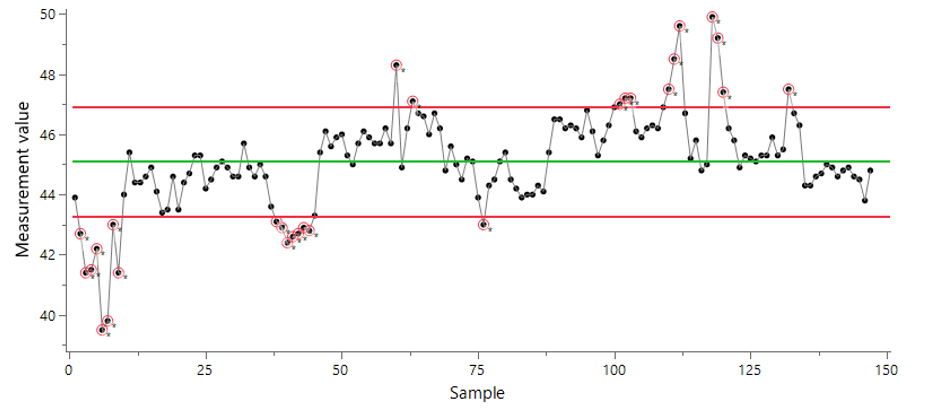

Potential capability
“Potential” capability: The limits in figure 1 provide an approximation* of the capability to expect IF, and only IF, the assignable causes in this process are identified and effectively controlled.
The “IF” here is key:  Without action on the assignable causes this “potential” capability has no meaning.  Note the elephant in the room:  No predictability = No actual process capability.
In this example, and because action on the assignable causes was planned, and did happen, the useful information in the potential capability was this: Achieve a predictable process and a capable process shall be expected. (This is because the limits in figure 1, 43.3-46.9, fall inside the specification range of 42.5 to 47.5.)
*This approximation is essentially an upper bound, but this point is secondary in the bigger picture of what capability means for an unpredictable process.
