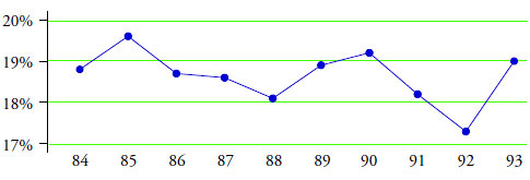

n my February 1996 Quality Digest column I discussed an article out of USA Today. Since that article provides a great example of how we need to filter out the noise whenever we attempt to interpret data, I have updated it for my column today. “Teen Use Turns Upward” read the headline for a graph appearing in USA Today on June 21, 1994. The data in the graph were attributed to the Institute for Social Research at the University of Michigan and were labeled as the “percentage of high-school seniors who smoke daily.”
The portion of this graph covering the 10 years from 1984 to 1993 is shown in figure 1.
https://lh3.googleusercontent.com/_CMMbz69LersWinA1zmZTLgqS7b2Mnu3g3o_N5I1VMeSJm0zQLXTS8BS23dclWUnHy6ulvfJe0wT_LBhe5J6iGUYV426st4UcQdZgvg7CFEyiuHyo9g
Figure 1: Percentage of high-school seniors who smoke daily
Each point in figure 1 is the value found in an annual survey. The 1993 value of 19.0 percent was higher than the 1992 value of 17.3 percent. This was interpreted to mean that more teenagers are using tobacco now than in the past. But are they?
