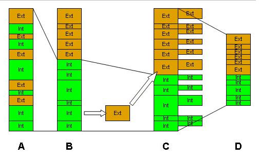

There are seven basic steps to reducing changeover using the SMED system (see figure 1):
1. Observe the current methodology (A)
2. Separate internal and external activities (B). Internal activities are those that can only be performed when the process is stopped, while external activities can be done while the last batch is being produced, or once the next batch has started. For example, go and get the required tools for the job before the machine stops.
3. Convert, where possible, internal activities into external ones (C) (preheating tools is a good example).
4. Streamline the remaining internal activities by simplifying them (D). Focus on fixings—Shingo rightly observed that it’s only the last turn of a bolt that tightens it—the rest is just movement.
5. Streamline the external activities so they are of a similar scale to the internal ones (D).
6. Document the new procedure and actions that are yet to be completed.
7. Do it all again: For each iteration of the above process, a 45-percent improvement in setup times should be expected, so it may take several iterations to cross the 10-minute line.
Figure 1: SMED method illustrated

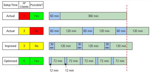

Figure 2 shows four successive runs with learning from each run and improvements applied before the next.
• Run 1 illustrates the original situation.
• Run 2 shows what would happen if more changeovers were included.
• Run 3 shows the effect of the improvements in changeover times that come from doing more of them and building learning into their execution.
• Run 4 shows how these improvements can get you back to the same production time but now with more flexibility in production capacity.
• Run N (not illustrated) would have changeovers that take 1.5 minutes (a 97-percent reduction) and whole shift time reduced from 420 minutes to 368 minutes a productivity improvement of 12 percent.
Figure 2: Four successive runs using SMED

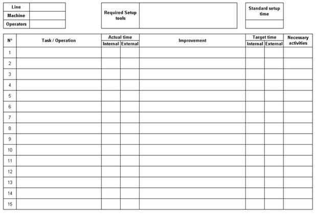

Record all necessary data using a form such as that shown in figure 3.

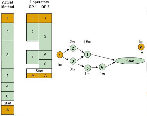

Parallel operations using multiple operators
By taking the “actual” operations and making them into a network, which contains the dependencies, it is possible to optimize task attribution and further optimize setup time. Issues of effective communication among the operators must be managed so that safety is ensured where potentially noisy or visually obstructive conditions occur. This idea is illustrated in figure 4.
Figure 4: SMED with multiple operators
