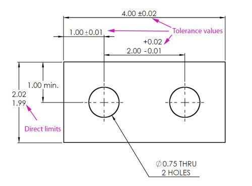

Figure 1: An example of tolerance values on an engineering drawing. Credit: McGill University
Almost any mechanical engineer is familiar with a type of error propagation called tolerance stacking or stack-up. It results when the tolerances for each part in an assembly add up, or stack, in a particular direction, causing the final assembly to not work for its intended use.
No part can be made exactly to specification. There will always be some error in the process that makes that part. So, when parts are designed, the designers tell the machinist, in the case of a machined part, just how much error is acceptable—the tolerance. Tolerances appear on most dimensions in an engineering drawing, like the one shown in Figure 1, where the overall width of that part is 4.00 ±0.02. That means that, once built, that dimension must be between 3.98 to 4.02.

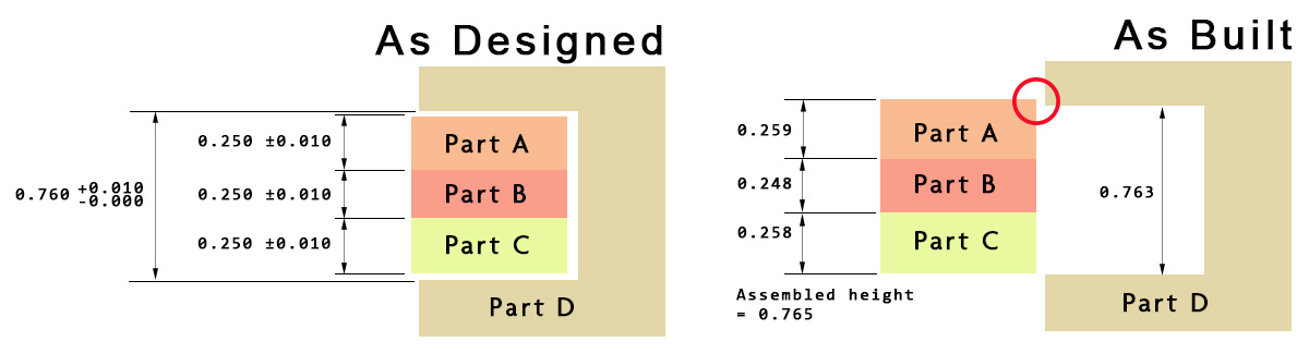

All this works well when parts are used in a simple assembly. For complex assemblies involving many parts and tight tolerances, a situation can occur where each part is made within specification but all the tolerances stack up such that the completed assembly won’t work.
In the Figure 2 example, we have Assembly ABC made up of Parts A, B, and C. These parts, once assembled, must fit into the slot on Part D. As designed, Assembly ABC will have a nominal height of 0.75 and will easily fit into the slot in Part D, which has a nominal width of 0.76.
Once all the parts have been machined, the tolerances of Parts A, B, and C add up to create an assembly measuring 0.765, which is bigger than the slot in Part D of 0.763. Every part was built to spec, but the final assemblies won’t fit due to tolerance stacking.
Figure 2: In this example of tolerance stack-up, even though all parts are built within tolerance, the final assemblies won’t fit together.
Fortunately, this problem is well understood. Designers and design software can detect whether tolerance stacking will be a problem. The issue can then be addressed at the design stage.

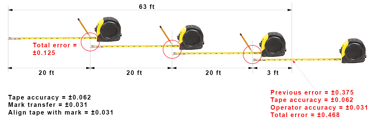

Figure 3 shows a simple example. We need to locate a point 63 ft from the end of a wall. If we had a high-quality, 100-ft steel tape, we would just measure 63 ft directly and know that we’re accurate to less than one-quarter inch—the accuracy of most 100-ft professional tapes.
Figure 3: Just like part tolerances, measurement tolerances can also stack up.
But suppose all you have is a 20-ft tape with an accuracy of about one-sixteenth inch (0.063 in.). You’ll have to make four back-to-back measurements to measure 63 ft. However, each time you make one of those moves, you’re adding three sources of error: tape-measure accuracy of 0.063 in.; how accurately you marked the wall with your pencil at the 20-ft mark (call that 0.031 in., about one-thirty-second in.); and how accurately your measurement assistant holds the end of the tape at that mark so you can extend the tape another 20 ft (call that an additional 0.031 in.).
Each time you move the tape, you’re adding about one eighth in. (0.125 in.) of measurement uncertainty. Do that three times, add the 0.063 in. tape accuracy and 0.031 in. operator accuracy for your last reading, and you have a potential of about one-half in. error for the overall measurement. This doesn’t even include error due to how tightly you pull the tape, or even the outside temperature, which also affects the accuracy. Who knew measuring could be so hard?

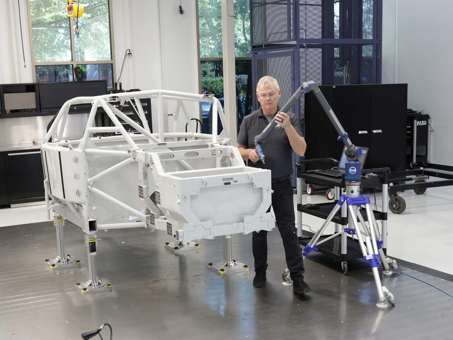

Figure 4a: An automobile frame being measured with a Quantum X FaroArm. Credit: FARO, a business of AMETEK.

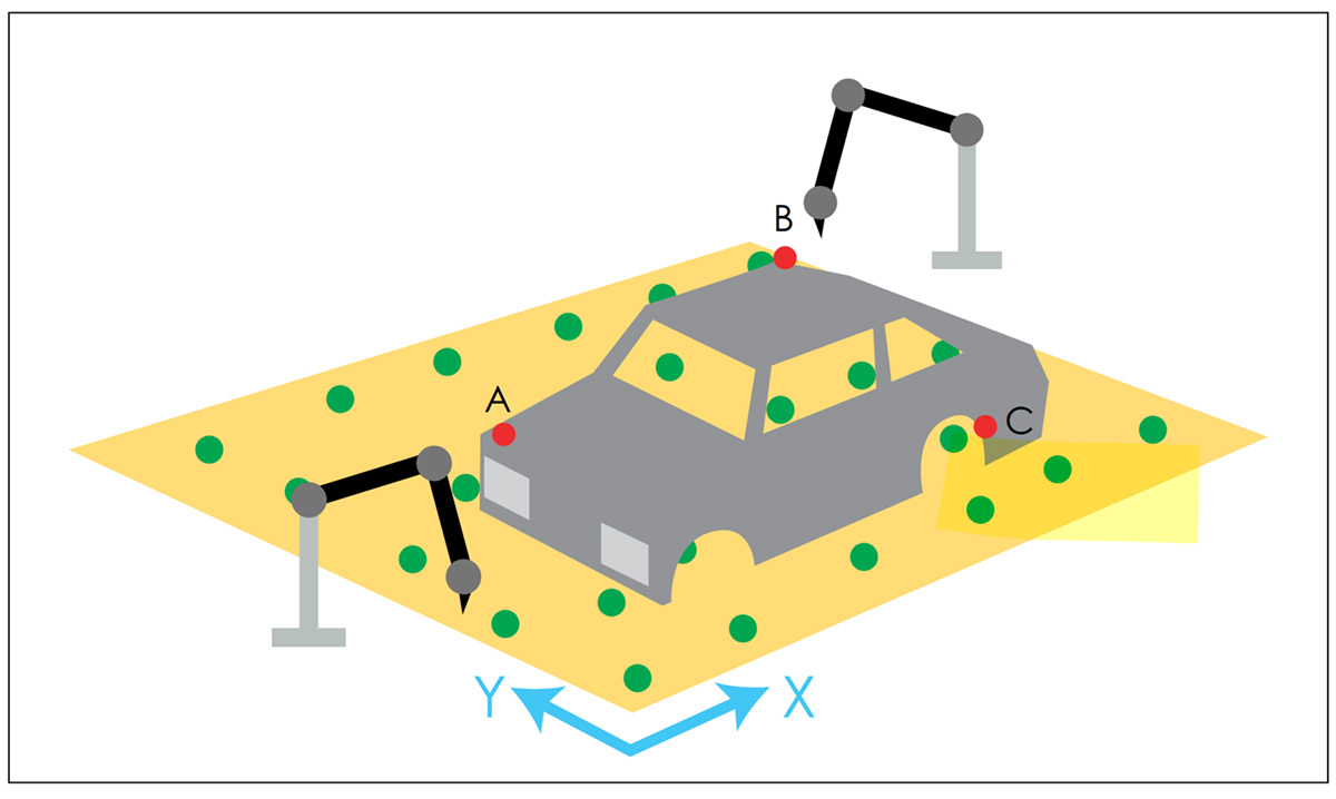

Figure 4b: In order to measure the entire frame, it might be necessary to “leapfrog” the FaroArm around the frame, adding a small amount of measurement uncertainty.
This kind of error can also happen in a manufacturing environment when measuring large objects, such as an entire car frame or an aircraft wing. In those cases, it’s often necessary to leap-frog measurement equipment.
Figure 4a shows a Quantum X FaroArm portable measurement arm. This particular FaroArm has a length of about 2 m (6.6 ft), which means a measuring envelope of about a 12-ft sphere with an accuracy of 23 microns (0.0009 in.).
That’s the accuracy of a measurement taken at one location. But suppose you use the arm in two locations to measure the entire car frame (see Figure 4b). Each time the arm and its base are moved, the measurement uncertainty increases.
That uncertainty can be calculated, and depending on the purpose of the measurement, the extra uncertainty introduced by leapfrogging might not matter. But it does have to be understood.

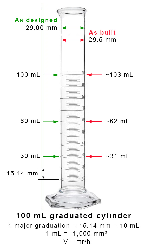

Figure 5: A small difference in the diameter of this graduated cylinder will cause a significant error in the reading as you measure greater and greater volumes.
In Figure 5, we have a graduated cylinder used for precise liquid measurement. These are made to exacting standards where the inside diameter and distance between marks are tightly controlled. In this 100 mL graduated cylinder, the inside diameter is 29.00 mm, and the distance between major marks is 15.14 mm. With a Class B graduated cylinder, the final accuracy of the cylinder should be 1 mL, or 1% at full scale; for a Class A cylinder, it’s 0.5 ml, or 0.5%.
Suppose during setup or inspection the person measuring the inside diameters (ID) of a batch of cylinders is off by 0.5 mm, or 500 microns; the inspector reads the ID as being 29.00 mm (when it’s actually 29.5 mm), and he passes the batch.
That difference is about the thickness of a high-quality business card, but when that error is plugged into the equation for the volume of a cylinder, it translates to about a 3.5% error. That means that at 30 mL, the reading would be off by 1 mL; at 60 mL, the error would be about 2 mL; and at 100 mL, the error would be greater than 3 mL, three times the stated accuracy of the graduated cylinder—all due to an error no bigger than the thickness of a business card.
