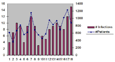

‘Because we worked so hard!’
I was at a conference where one of the poster sessions proudly declared that they had reduced infections in a pediatric unit. It used the following display:
