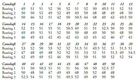

The data we shall use are the maximum observed diameters for the three bearing surfaces of an automobile engine camshaft. The nominal dimension is supposed to be 1.3750 inches. The values recorded are the last two digits of 1.37xx, expressed in increments of a ten-thousandth of an inch. One camshaft is measured out of each tray of camshafts produced. The data for 50 consecutive trays are found in figure 1. Each of the three bearings for a camshaft is produced on a different piece of equipment, so it’s logical to want to compare these three operations.
Figure 1:  Camshaft bearing diameters
