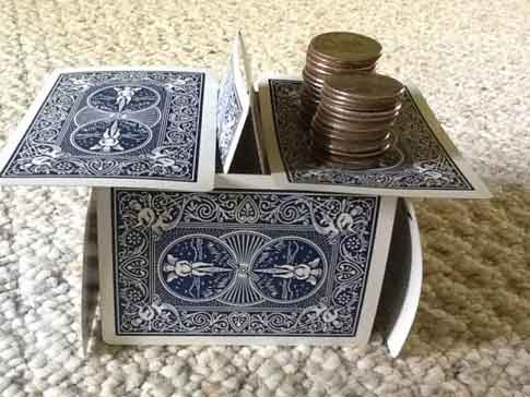

To illustrate this study, and to relive my childhood, I built some good old-fashioned card houses and tested how their roofs held up to stress loads of up to 50 U.S. quarters.
At each stress load, I tested 10 card houses and recorded how many collapsed. Here are the results, recorded in a Minitab worksheet:
