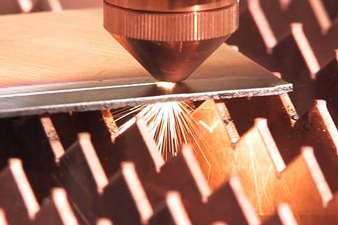

Now MIT Lincoln Laboratory spinout TeraDiode is commercializing a multikilowatt diode laser system that’s bright enough to cut and weld—even through a half-inch of steel—at greater efficiencies than today’s industrial lasers.
The 4-kilowatt TeraBlade runs on a novel power-scaling technique developed at MIT that manipulates individual diode laser beams into a single output ray. This allows for boosting the power of a diode laser, while preserving a very focused beam.
