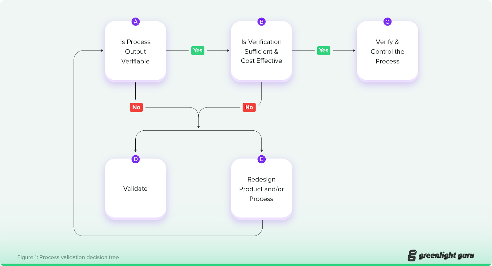

In a highly regulated industry like medical technology, manufacturing processes must undergo either process verification or process validation to ensure they’re consistently producing the correct result. The question is, which one should you use?
Verification and validation are two different activities, and they’re used under different circumstances. Knowing when to validate or verify a process is essential from both a quality and regulatory perspective.
So, let’s take a look at what process verification and process validation refer to, and when you should use each of them in medical device manufacturing: What’s the difference between process verification vs. process validation?

Verification - Sample Plans
If a feature can be verified, but you do less than 100% verification using a sampling plan, does the process still require verification? This is a source of debate at our facility. Some features can be verified/measured and the sample is indicative of the process yield. The differing schools of thought are verification in lieu of validation is 100% verification of the feature(s). Validation should be performed for processes as cited in the guidance and this article, but also for any features that are sampled (not 100%). Another thought was that a simple process capability study versus a full-on IQ/OQ/PQ validtion can be used.
Submitted by jandell on Wed, 02/22/2023 - 10:26
Clarification
So, is Verification the assessment of the process output relative to its specs? Is validation assessment that the process procedures are being followed, because the output might be difficult or perhaps even impossible to verify? Or am I still missing the point?
