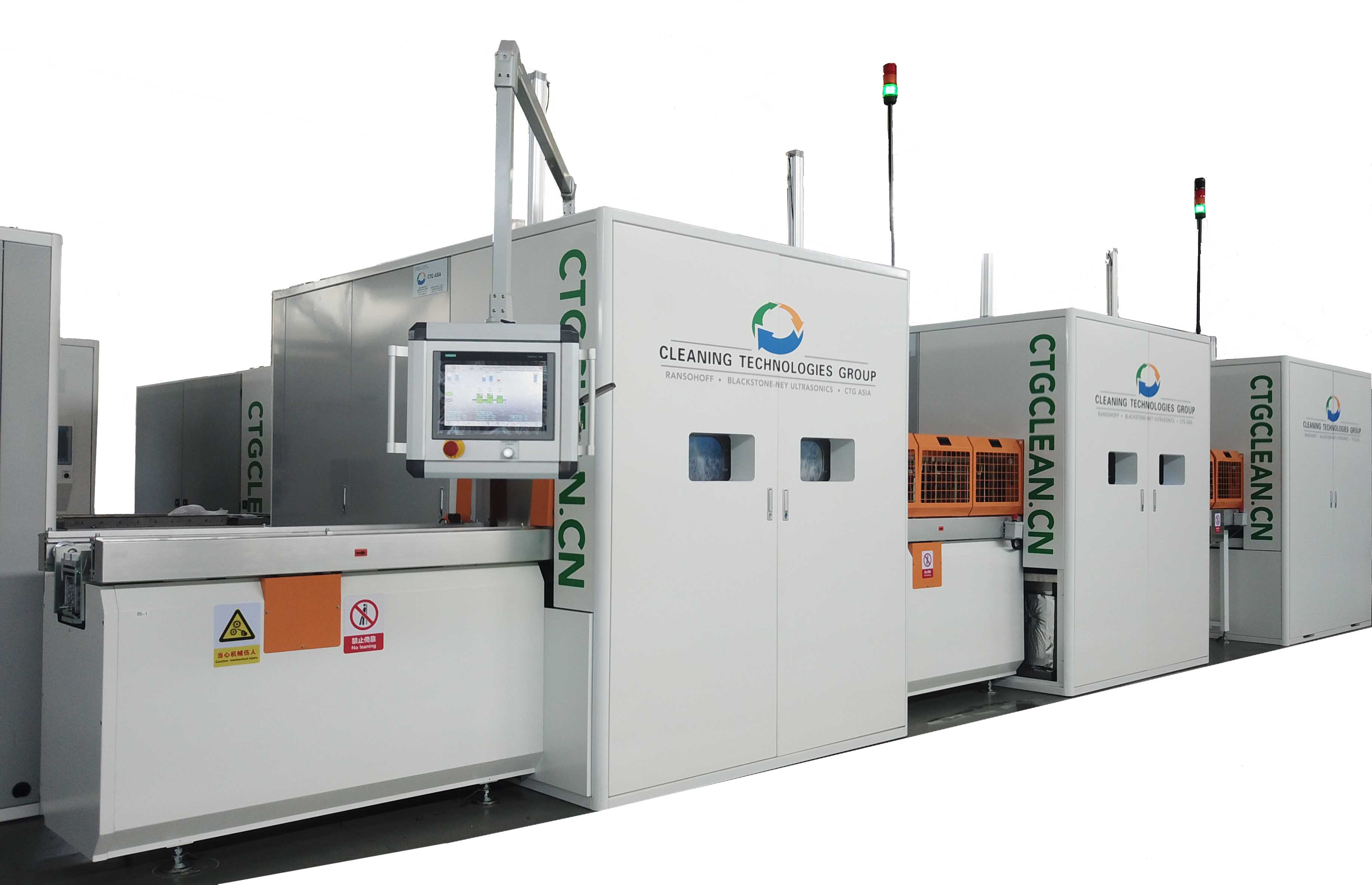

(Ransohoff: Cincinnati, OH) -- A division of the Cleaning Technologies Group LLC, Ransohoff has introduced a new modular automated cleaning system. The RBS Modular System is an automated immersion cleaning system that can be expanded as needed to meet your process requirements.
It’s a dedicated in-line process that includes a wash, rinse, ultrasonic wash, ultrasonic rinse, heated blow-off, and a final vacuum drying system. This system is set up to process parts in a basket or on a fixture. The RBS Modular System can handle parts up to 1,100 lb (500 kg) and can do up to 15 cycles per hour.
The RBS Modular System cleans using a washing and rinsing process of agitation, spray impingement, hydraulic purging through immersion and rotation, ultrasonics, and heated blow-off drying. The “triple action” batch cleaning process was developed specifically to process a broad range of challenging parts, especially those with internal bores and passages and complex geometries, making this system capable of meeting critical cleaning expectations.
