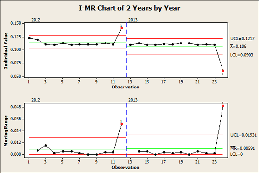

This I-MR chart displays the data in two distinct phases by year

An Individuals chart of the differences between this year’s data and last year’s might not be our best approach. Another approach is to look at all of the data together.  We’ll put this year’s and last year’s data into a single column and see how it looks in an individuals chart. (Want to play along? Here’s my data set.)
