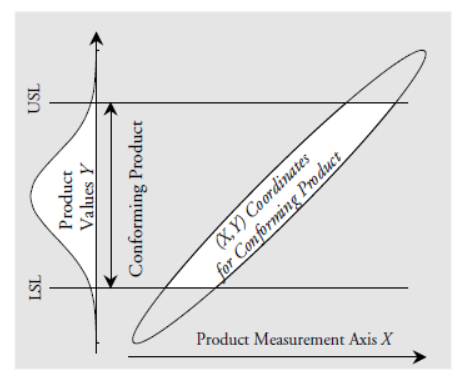

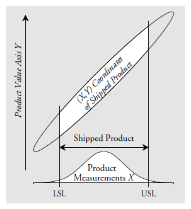

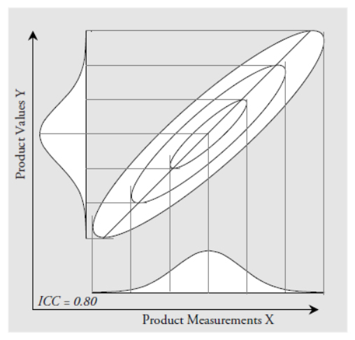

A product measurement, X, may be thought of as consisting of the product value, Y, plus some measurement error, E, so that X = Y + E. With this model, the relationship between X and Y can be shown using a bivariate normal probability model where:
