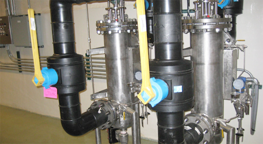

Industrial water filtration
Power plants with cooling towers as well as other industrial applications depend on reliable, efficient filtering of debris from the water to prevent excessive maintenance and downtime.
Because the cooling water originates from bodies of water, it can be dirty, with considerable debris, weeds, and trash. Strainers are required to remove the waste from the cooling water before it goes into heat exchangers and cooling systems, and to prevent spray nozzles from clogging.
