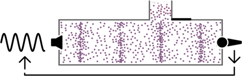

(NIST: Gaithersburg, MD) -- Researchers at the National Institute of Standards and Technology (NIST) have developed a new—and sound—way to accurately measure the rate at which gas flows in and out of a vessel. The technique, which uses acoustic waves to determine the average temperature of the gas and microwaves to ascertain the volume of the vessel, can measure gas flows and leaks from large containers particularly well.

Schematic depicts sound-wave transmitter and receiver (microphone) placed at opposite ends of a gas-filled chamber. Credit: S. Kelley/NIST
