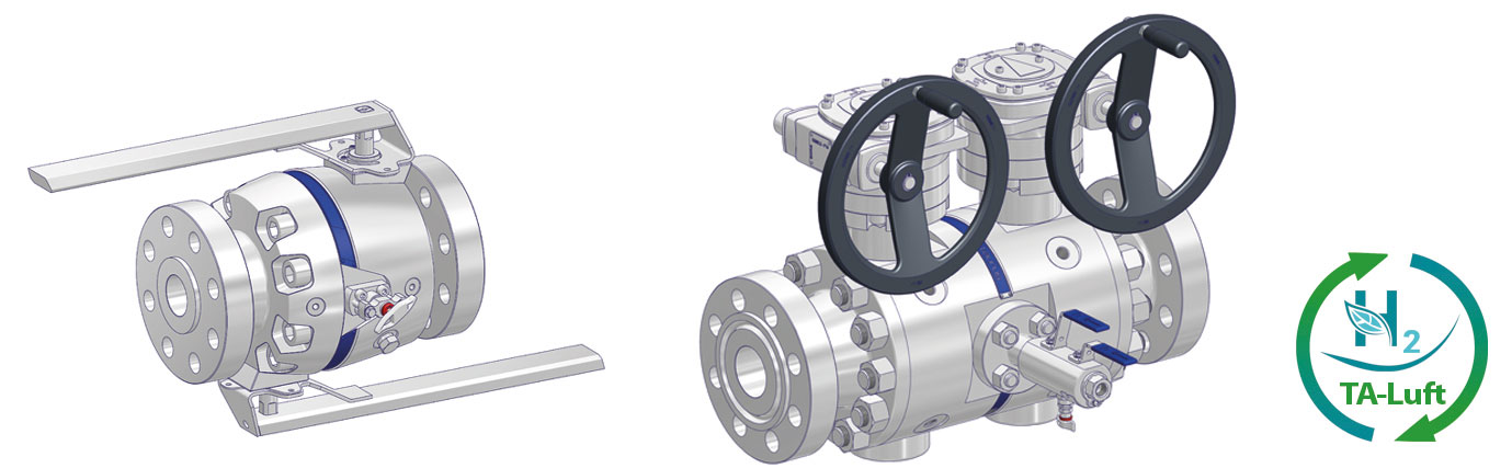

Hydrogen-compliant DBB piping ball valves.
Valves for hydrogen applications
AS-Schneider’s valves have been successfully used for hydrogen for more than 20 years—all valves and manifolds as well as the DBB ball valves are suitable for this purpose. The instrumentation and piping valves can also be used safely in natural gas applications with, for example, a 20 percent hydrogen blending. This feature is particularly interesting for natural gas plant operators and gas network operators who want to convert their natural gas pipelines for hydrogen.
AS-Schneider recommends austenitic stainless steel 316 or 316L as the optimum material for instrumentation and pipeline valves in the hydrogen industry. Other materials are also possible, but those responsible should ensure that nonmetallic valve materials such as seals and lubricants are compatible with the hydrogen medium. There are lists of these in the standards and norms (Sandia, ISO/TR, SAE).
When users select the appropriate valve head unit, they must first check whether the operating environment is closed or open. If the environment is open, they can use the standard valve head unit from AS-Schneider. If the valve is mounted in a closed, nonventilated environment—which could be a protective shade or a container—it increases tightness requirements. Those will be covered with special valve inserts (Fugitive Emission Standards like TA-Luft or bellow-sealed valves).
Plant operators should consult the hydrogen experts at ADIPEC to find the right material and valve head units for their specific requirements.

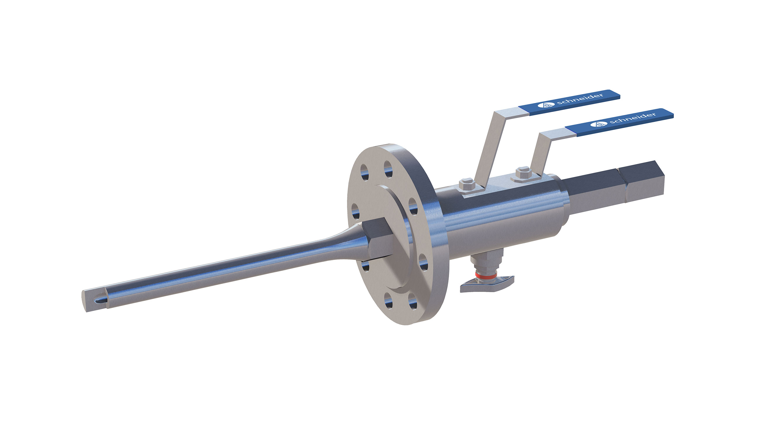

The customized injection quill consists of two shut-off valves and one bleed valve.
An injection quill or sampling quill with an integral DBB valve and check valve is pretty much a custom-designed product. From the unique process conditions to the custom length and dimensions, many parameters must be taken into consideration. This is where AS-Schneider comes into play.
The injection quill could come in various configuration, connections, and valves, from a simple fabricated tube/probe to an integrated assembly with isolation valves and nonreturn valves. AS-Schneider manufactures an integrated chemical injection quill, complete with probe, double block-and-bleed assembly (two isolation valves and one bleed valve) and an integral nonreturn check valve, all in one compact assembly. Referring to the above illustration, this injection quill can also be converted into a sampling quill by a redesign on the probe and without the integral check valve. Sampling quill is used to safely take out fluid samples from the process line for analytical or laboratory purpose.
This type of quill is mounted into the pipeline through a fitting so the quill/probe is inserted and extends down to the center of the process line. The other end is connected to the chemical feed line by pipe or tubing connections all the way back to the chemical-injection skid or chemical dosing packages that house the pump and chemical tank.
When designing an injection quill, the following points must be considered:
• Design calculation
• Material
• Safe isolation
• Dimension
• Nozzles
• Mounting options
Because of the numerous factors that must be considered in the selection and installation, it is recommended that you consult the experts: So, visit Booth 8840 to discuss your individual application.
