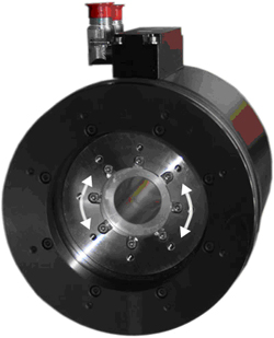

(Promess Inc.: Brighton, MI) -- Promess Inc. has added a series of hollow-shaft units to its line of Torque Functional Test (TFT) Systems intended for intelligent assembly applications. Based on direct drive rotary motor technology, the new TFT-HS series permits users to access components with tools and/or sensors inserted through the center hole during the assembly operation.
Promess TFTs provide monitored and measured amounts of torque during assembly and test operations. They utilize servomotors, precision position sensing feedback technology, and extremely accurate, proprietary torque transducers to produce controlled torque inputs and feedback monitoring.
“A hollow-shaft TFT greatly simplifies the design of many test and assembly machines by eliminating the need for complex tooling,” explains Promess president, Larry Stockline. “For example, one could adjust the backlash in a gear set by applying axial force through the center hole with a press while the TFT provides the necessary rotation to tighten a fastener or other adjustment mechanism.
