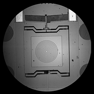

(NIST: Gaithersburg, MD) -- Researchers at the National Institute of Standards and Technology (NIST) have demonstrated a microminiaturized device that can perform complex viscosity measurements—critical data for a wide variety of fields dealing with things that have to flow—on sample sizes as small as a few nanoliters. Currently a table-top prototype, the NIST rheometer could be a particularly valuable tool for biotechnologists studying minute quantities of complex materials that must function in confined spaces.
