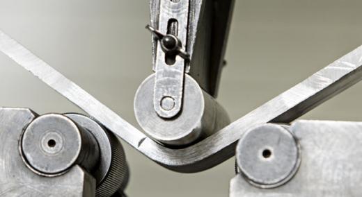

What is destructive testing?
Destructive testing (often abbreviated as DT) is a test method conducted to find the exact point of failure of materials, components, or machines. During the process, the tested item undergoes stress that eventually deforms or destroys the material. Naturally, tested parts and materials cannot be reused in regular operation after undergoing destructive testing procedures.
Destructive testing is generally conducted before a component enters mass production. OEMs need to know the limits of their products in order to give proper maintenance and operating recommendations for their machines.
