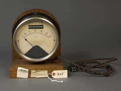

T. Jach writes:
“Item 0554 is clearly a frequency signal meter that is centered at 25 hertz. The indicator at the top is a series of reeds that have slightly different lengths. The reed that is in resonance with the input signal vibrates the most. The meter has a very narrow range, which would be consistent with using the indicators to regulate, for example, an alternator that operates at 25 hertz.”
