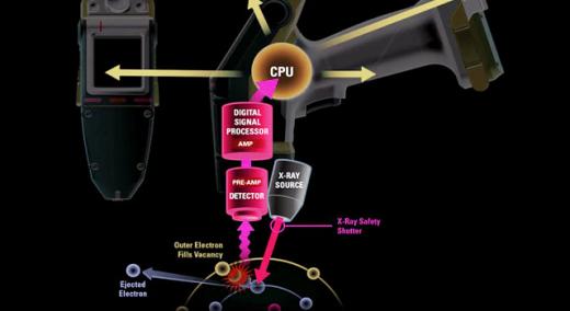

X-ray fluorescence (XRF) is an analytic method used to define the elemental structure of a material. Companies use specific XRF instruments when determining the chemistry for a sample of a material. How is this done? The machine measures the secondary or fluorescent X-ray that is released after being stimulated by the primary X-ray source.
Every component in any given sample makes its own set of characteristic fluorescent X-rays that are as individual as a human fingerprint. That is why spectroscopy designed specifically for X-ray fluorescence is ideal for generating both a quantitative and qualitative examination. Another major benefit of XRF is that it’s a nondestructive technique.
