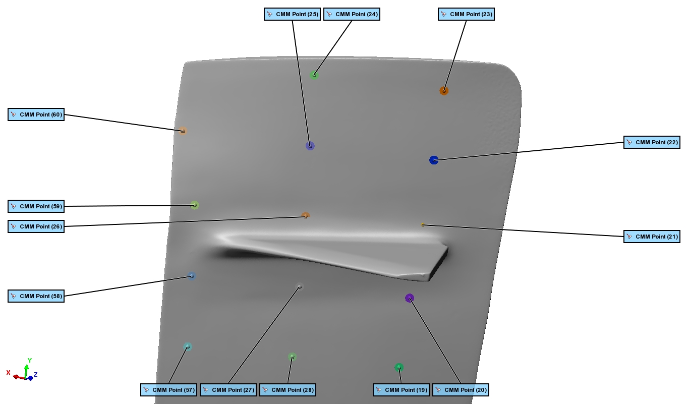

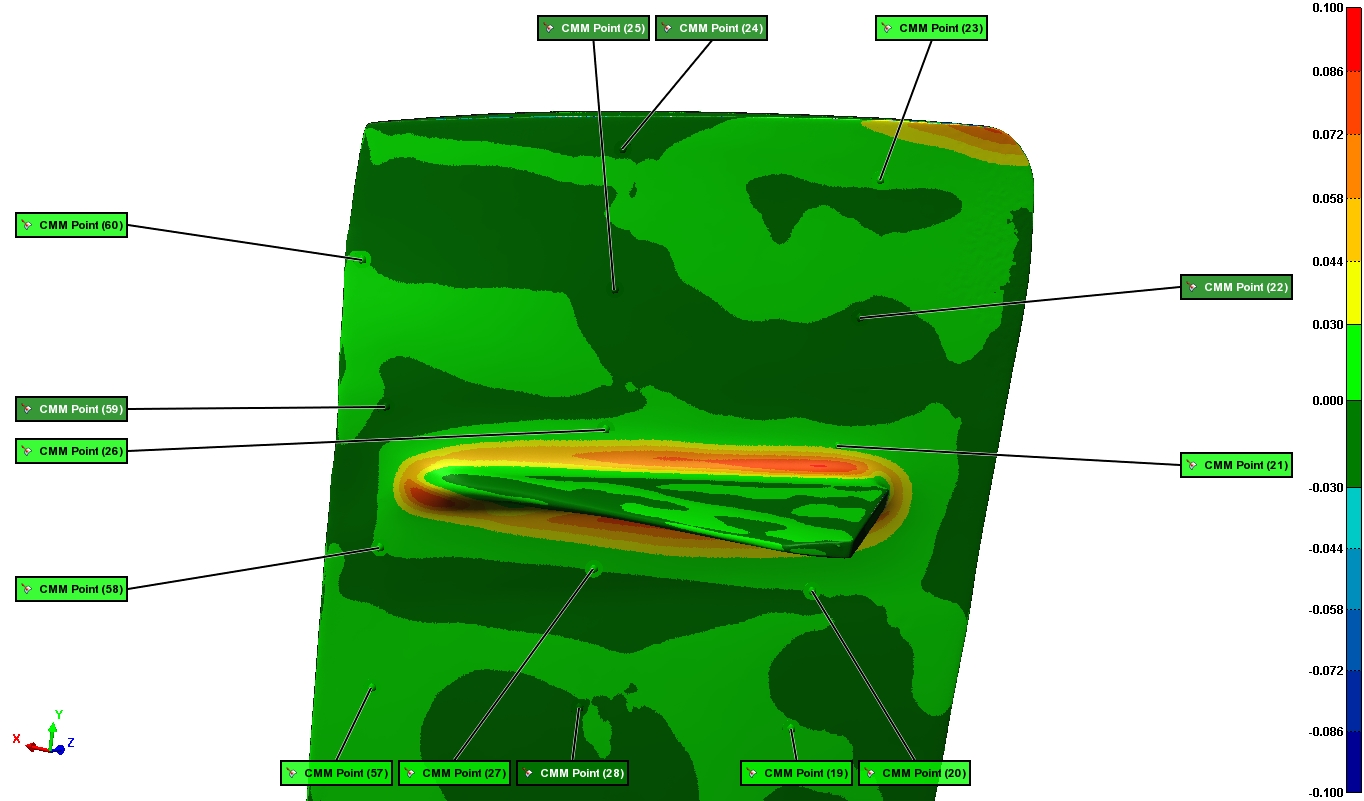

A customer recently came to us with the following scenario. An engineer at his company was boasting of having produced the “perfect part,” based on CMM deviation points. Our contact had used our scanning services in the past. We performed a quick blue-light 3D scan on the object and quickly determined the part was out of spec on several faces because certain critical points had been missed in the CMM protocol. Our millions of scan data points were fit to the deviation map, and the problem was tracked backed to the production source and rectified. Today, this company is a regular customer.
