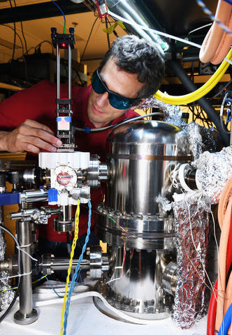

NIST scientist Stephen Eckel behind a pCAVS unit (silver-colored cube left of center) that is connected to a vacuum chamber (cylinder at right). Credit: C. Suplee/NIST
