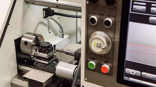

CNC milling machines are considered the ideal solution for preparing tensile specimens

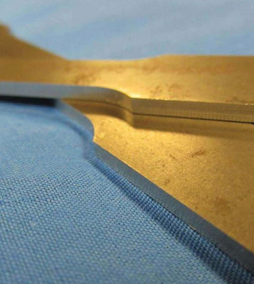

The specimen’s cut is critical to the quality and accuracy of its test results. The sample must not have any jagged edges or nicks. Even the slightest such deformity can impact its tensile strength, affect the ability to receive consistent tensile results from the specimen, and render its test results out of line with other similar specimens.
Once a specimen is correctly cut, it must also be handled with care. Dropping, bumping, or otherwise mishandling the specimen may result in nicks, with the same effect on testing as a bad cut.
