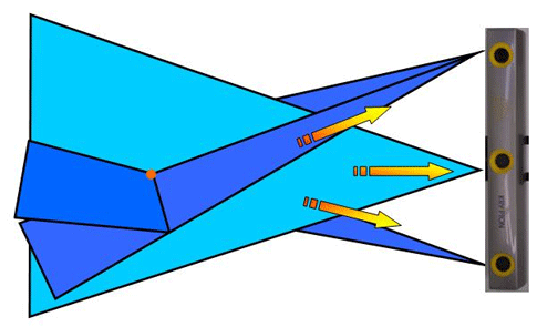

While the technology comes in different “flavors,” most optical CMMs work around a similar principal. For instance, Nikon Metrology’s optical CMM (KCMM) begins with three linear CCD cameras. When light from an active LED is detected, the three cameras triangulate its position in space.
