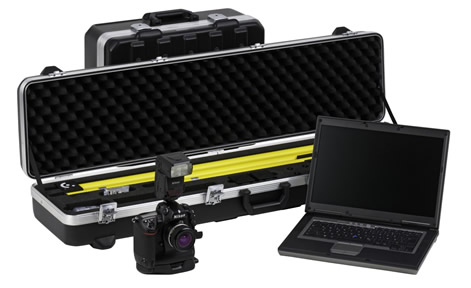

Optical 3-D coordinate measuring system
For this application a TRITOP CMM was used. This instrument, manufactured by Capture 3D, is a portable optical measuring system that precisely determines 3-D coordinates of specified object points (see figure 1). The gauging points are easily marked with self-adhesive or magnetic markers before the measuring process (as seen in figure. 2).
