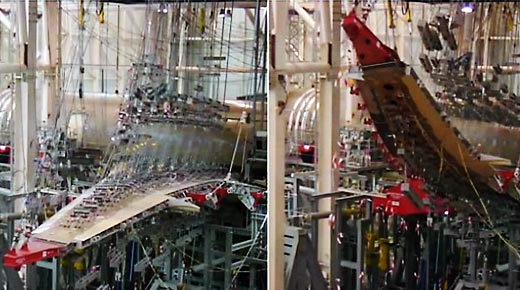

Virtually stressing airplane wings
Scientists have found a way to improve the simulation of the onset of failure in airplane wings.
Credit: Airbus
