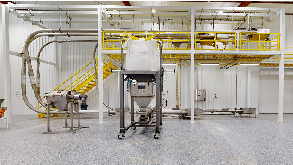

Automated Handling Solutions Germany GmbH Test Center in Friedrichsdorf, Germany
