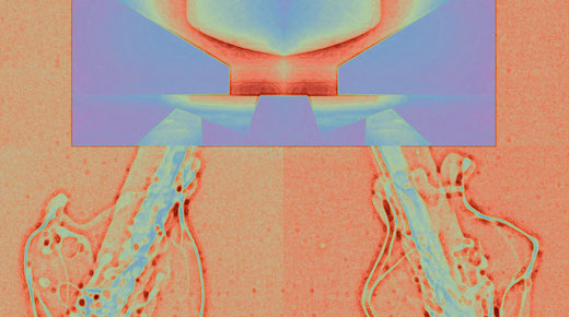

Poor manufacturing cleanliness can affect the performance of fuel injectors
Credit: Argonne National Laboratory
